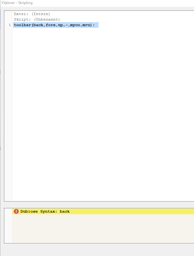

Can someone rewrite this script so that no menu opens, but that the toolbar changes with the script.
I would then create a button for each toolbar.

Excuse me, but I am not at all familiar with scripts. I got the menu above good. If I try that now, I always get an error message.
What am I doing wrong?
(OS: Windows 11 Pro on Parallels ARM Virtual Machine - XY: Current x64 beta - Display: 3440x1440 @ 125%)
Posts: 14672
Re: second toolbar
You need to put the list in quotes (either single or double). It's a string.

super thank you for your help.
It works :D
