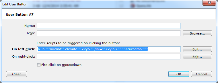

A workaround is go to http://www.nirsoft.net/utils/nircmd.html and download nircmd. Extract both executables and put them in C:\Windows\.
Now make a new Custom Toolbar Button. For the script, use:
There is some nice added benefits with the script above. XYplorer will open up a new process that is elevated. The old one will still be running so you won't lose anything. Do what you need with the elevated XYplorer process and then simply quite without saving. Voila!
Run """nircmd"" elevate ""<xy>"" /ini=""<xyini>"" ""<curpath>""";To see the attached files, you need to log into the forum.
