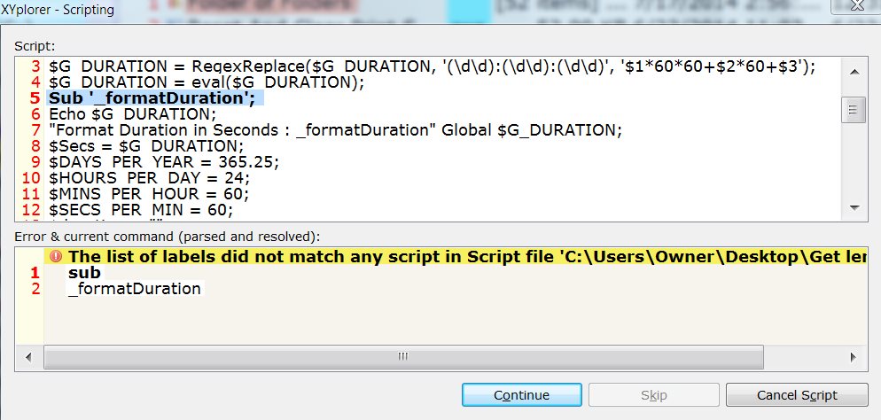

This must be crucial: // You may need to adjust the '{prop:*Length}' for your system. Do not comprehend and thus unable to implement the change. Instead, when XYS is run am presented with the screen shot below.

That error shouldn't be related to that comment.aurumdigitus wrote:This must be crucial: // You may need to adjust the '{prop:*Length}' for your system. Do not comprehend and thus unable to implement the change. Instead, when XYS is run am presented with the screen shot below.
If you see a length value after running the following script with your music files selected you don't need to mess with that line:
Text Report("{prop:*Length}<crlf>", 1);Your error is about it not finding the script to format the duration, so give the attached file a try instead.
