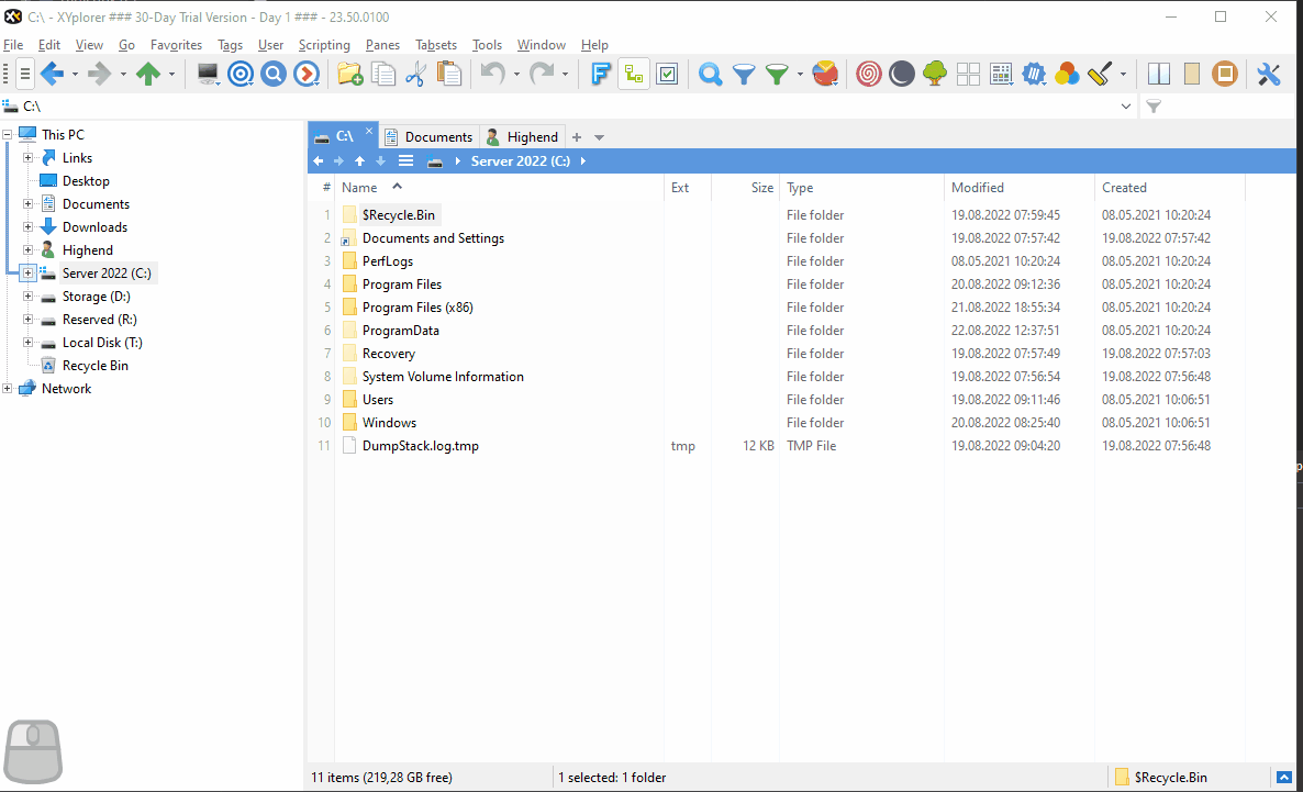

Tested your script from the first post. Apart from the problem that it's 32 bit only it works as expected. Right clicking on a context menu leads to a defined perm var...
