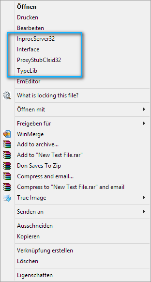

I usually don't use this stuff, but now I might need one. There are crap entries in hundreds of nodes, and some of them show in all of my shell context menus. This e.g. is the context menu of a TXT file:
So I have InprocServer32, Interface, ProxyStubClsid32, Typelib in the context menu of every file and it's totally useless. When I click on them I just get an error saying roughly (transl. from German) "No program is associated with this action...".
This goes on for a long time (some years), no idea when or why it started, but I decided it's time to get rid of it.

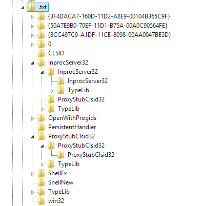

In the registry it's immdiately clear that things are just crappy:
So, I need a good Registry Cleaner. I know that the world of Registry Cleaners is full of rubbish. Is there one that is not rubbish?

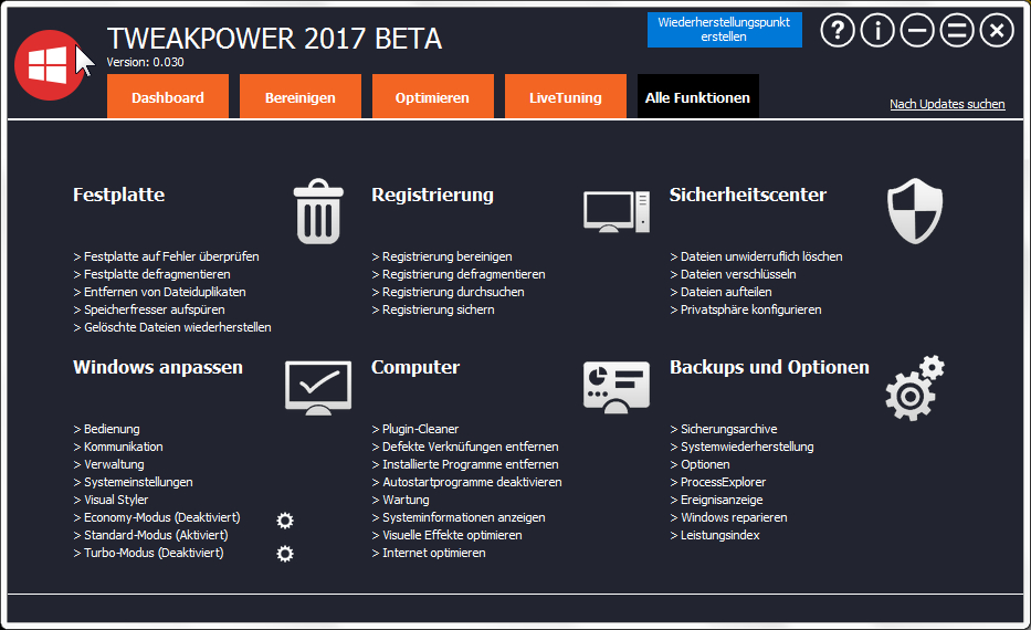

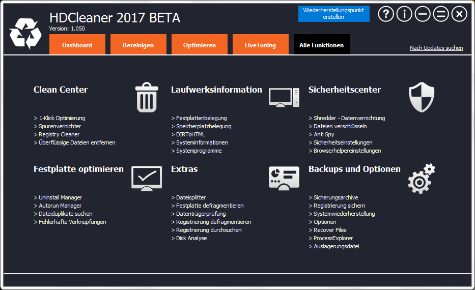

And for more thorough house cleaning - you said "... for years ...":
kurtzimmermann.com
flagship "TweakPower" or "HDCleaner"
Both portable (but not stealth).
He is working on these for a decade or so with permanence, quite regular updates.
(You may call it a downside, that he forces updates on you).

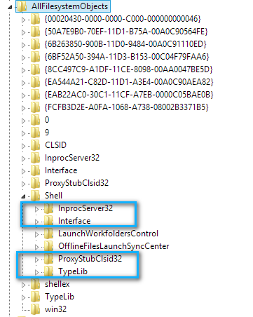

Ah, got it!
It was this key:
HKEY_CLASSES_ROOT\AllFilesystemObjects\Shell
Something wrote a load of crap into it:
After deleting the 4 undesired entries, all my context menus look alright again. :D
