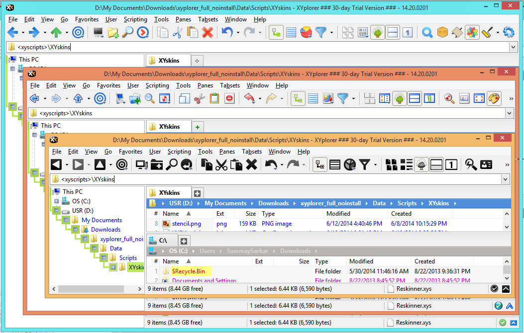

XYSkinner can apply custom skins to the default toolbar buttons.
preview
preview
This is a very early release, use with extreme caution. READ NOTES BELOW CAREFULLY.
Download XYSkinner.xys *
v1.1>>downloaded file was not named correctly (thanks SkyFrontier for noting). Much :oops: Sorry! Also, default icon is generated dynamically (from <xy>). you can delete default.ico now.
v1-reupload>>uses an alternative, faster link by default. Remember the download size should be 542 KB!
