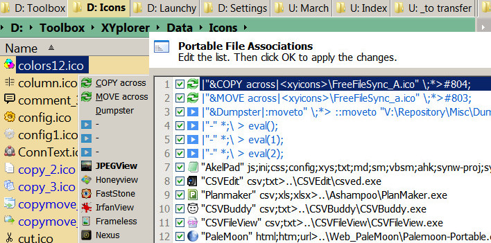

The separators are not working here. I get to see the "::eval();" instead of separators. I helped myself with dummy commands and empty spacer icons like this:
But it doesn't look nice. A far cry from real separators than span the whole width.
|"--------------|<xyicons>\spacer.ico" \;*>#614;-

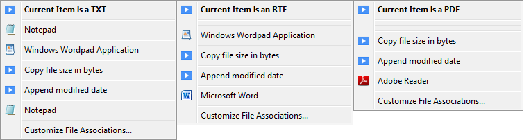

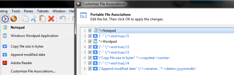

Given the following PFA in Editor Mode (pencil icon/F6) format:SammaySarkar wrote:???TheQwerty wrote:can quickly turn into a mess when the match patterns start changing what appears between the separators.
+"Current Item is a TXT" txt>end true;//txt
+"Current Item is an RTF" rtf>end true;//rtf
+"Current Item is a PDF" pdf>end true;//pdf
+|"-" \;*>end true;//0
+txt>Notepad
+|"-" \;*>end true;//1
+txt;rtf>Wordpad
+|"-" \;*>end true;//2
+|"Copy file size in bytes" *>::copytext <cursize>
+|"-" \;*>end true;//3
+|"Append modified date" \;*>::rename , '*-<datem yyyymmdd>'You have to think carefully about what's in a section and when you want the items and separators shown to determine what pattern should be used for matching those items and separators.

A screenshot for a screenshot. Post a screenshot of the misbehaving separator item in PFA editor. (and perhaps the resulting mis-menu)Stef123 wrote:Getting closer. I removed the +sign up front, to make it look more like on TheQwerty's screenshot. Now I see one single hyphen "-" (without parentheses) and the blue SC triangle icon.
btw, the format I posted is supposed to be pasted into a new line in editor mode (F6) or remove the + and paste as a new entry in normal mode
Stef123
Re: Context Menu > File List ... > ADD...
SammaySarkar wrote:the format I posted is supposed to be pasted into a new line in editor mode (F6) or remove the + and paste as a new entry in normal mode
In case you wonder about the missing colons :: - I had them too, makes no difference, tried all variations from verbatim your solution and that of TheQwerty's screenshot, plus all kinds of variants - no separator.
