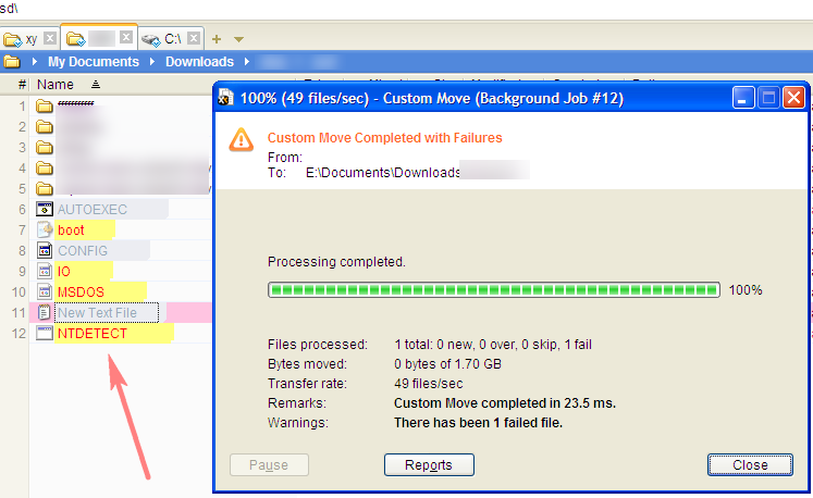

not sure if i understood you correctlyTheQwerty wrote:You should be able to just use the foreach loop's MsgOnEmpty parameter:Code: Select all
foreach($token, <get selecteditemspathnames |>,, 'Nothing selected') { moveto "<curpath>", "$token\*.*"; }
the result of executing above script while nothing selected;move system files from c to current folder
- Posts: 4373
- Joined: 03 Aug 2007 22:30
Re: prune dir
I dropped a comma, there should be three in a row - above script is corrected.yusef88 wrote:not sure if i understood you correctly

- Posts: 1148
- Joined: 28 Jan 2013 03:50
Re: prune dir
works only with one selected folder..thanks
