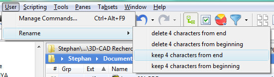

And then one could add these to the user commands with the result as in the picture. In the following preview the pattern can still be edited i.e. in order to set the number of 4 chars to 3 or 5.
- user-rename-commands.jpg (45.71 KiB) Viewed 3837 times
