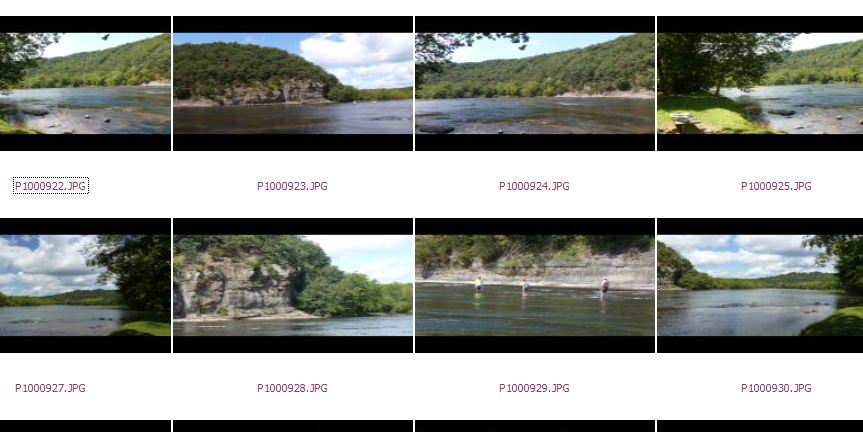

Hi, I've been experiencing one issue with the display of only certain thumbnails where the original picture is taken in a wide screen mode 16x9 at a resolution of 4320 x 2430 (jpg). As you can see from the attached screen clips (attach 1) of the thumbnails in XYplorer the upper and lower section has a dark border and it may be hard to tell but the picture in the thumbnail is actually squished to where it is not proportional.
attach 1 - XY thumbs (16x9).JPG (64.98 KiB) Viewed 4397 times
The picture itself is fine (i.e., proportional) and displays fine in MDBU or Irfanview. The thumbnail should actually take up the real estate of the blackened area as well to be at the proper aspect ratio. Thumbnails of pictures taken at other resolutions are displayed just fine (e.g., 4x3 ratio, 4320 x 3240). I was wondering if any of you camera smart and XY heavies may have any ideas on why this is? My settings are all typical. Super-fast thumbs unchecked, enable shell thumbs checked, enable folder thumbs checked, etc - we can only provide 3 attachments. When I take a 4x3 (4320 x 3240) resolution photo and then use Irfanview to crop it to a 16x9 at 4330x2430 resolution, the thumbnail is displayed just fine (attach 2).

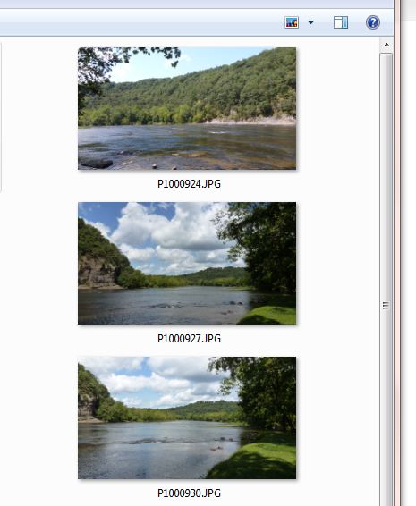

For other wallpapers and pictures at 16x9 ratio, the thumbnails are displayed absolutely fine. I'm not using any external codecs like Sagethumbs or others discussed on the forum. Now, this is the part the really bugs me, the thumbnails for the same photos display fine in that inept Explorer in Windows 7 (see screen clip attach 3).
attach 3 - Explorer thumbs.JPG (44.25 KiB) Viewed 4397 times

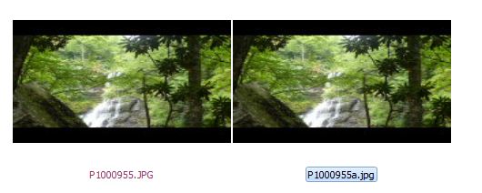

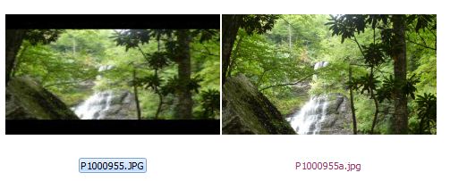

I don't know if this may help in troubleshooting what's going on with the thumbnails, but I took one of my pics at (4320x2432 res) which the thumbnail displays improperly in XYplorer and I opened it in Irfanview. I then saved the picture in 4320x2430 resolution. The thumbnail diplayed properly see attach 1.
XY thumbs.JPG (29.4 KiB) Viewed 4379 times
But, then I refreshed the cache and the same picture that displayed properly now displayed improperly. See attach 2.
XY thumbs after refresh.JPG (27.58 KiB) Viewed 4379 times
